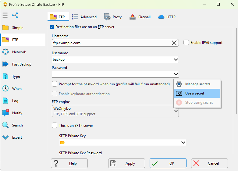

Creating secrets and using them in a profile
A connection gives SyncBackPro access to the vault. A secret tells it which item, and which field of that item, to use. One connection can be used by many secrets, and one secret by many profiles.
  1. In the Secrets Manager, go to the Secrets page, click Create and choose Username or Password.
  2. If you have more than one connection, choose the 1Password one. Then pick the item by its Name (its title in 1Password) from the list that SyncBackPro reads from the vault, and click OK. The Name dialog listing the logins in the 1Password vault, with SFTP Server highlighted
  3. A Description is filled in with the item's category, Login or Password. Change it if you like; it is for your own reference.
  4. If the item has both a username and a password, a Key dialog asks which one to use: username or password. If it has only one of them, that one is used without asking. Click OK.
  5. Now open the profile, either in the New Profile Wizard or with Modify. Beside a field that can take a secret, for example the FTP password, click the drop-down button and choose Use a secret. Pick the secret and click OK. The drop-down menu beside the FTP password field in a SyncBackPro profile, showing Manage secrets, Use a secret and Stop using secret
The hint on the drop-down button shows which secret the field is using. The same menu has Manage secrets and Stop using secret, and once a secret is in use, Use a secret becomes Change secret, followed by the name of the secret.
