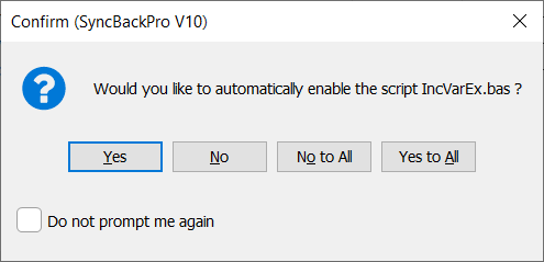

4. You then need to activate the script. If it's a Main Interface or Profile Configuration script, you can immediately activate it after installation. Simply click on the Yes button when prompted.
Activate Script
Alternatively, go to the relevant tab on the Scripts page and tick the checkbox next to the script to activate it.
Activate Script
