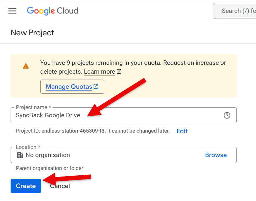

Creating a Project
First, we must create a project:
  1. Go to the Google Developers Console: https://console.cloud.google.com/
  2. Click the Select a project drop-down menu on the top-left corner of the page. A pop-up window appears on the screen.
  3. Click New project on the top-right of the pop-up window.
  4. Enter a Project name, e.g. SyncBack Google Drive, then click the Create button. It may take a while for the project to be created.

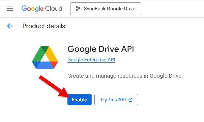

  1. Click the burger menu on the top-left of the window and select Enabled APIs & services.
  2. Check that you have selected your Google Drive project (at the top-left), then click + Enable APIs and services at the top of the window.

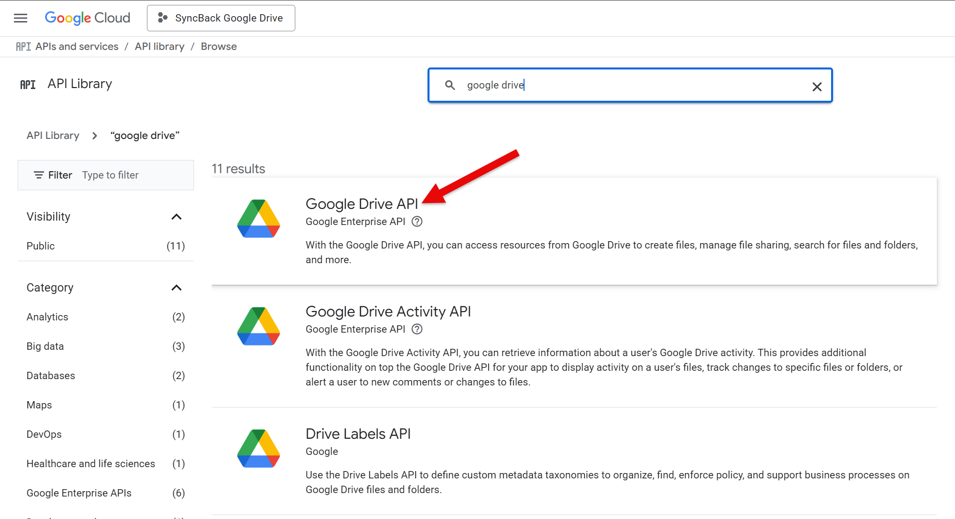

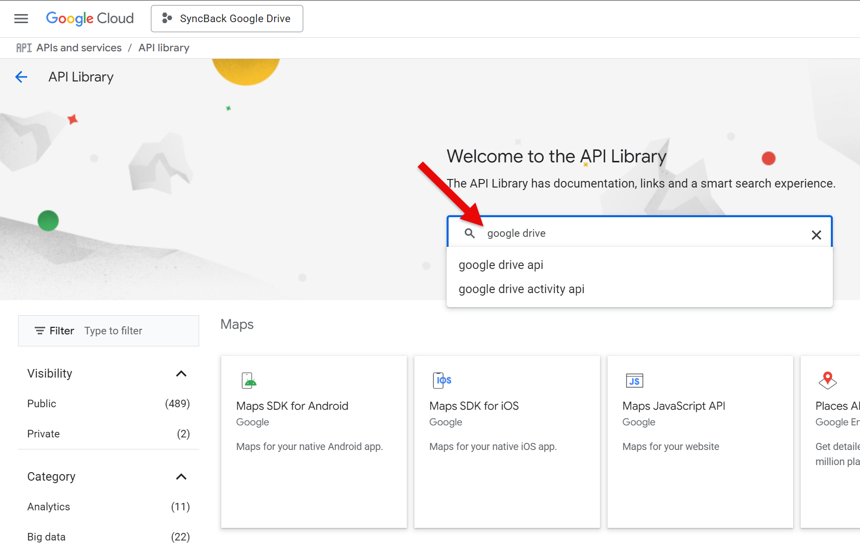

  3. Enter google drive into the search box and press Enter
  4. Click the Google Drive API box...

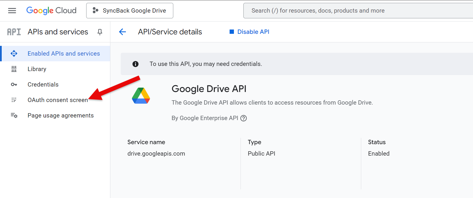

  5. ...then click the Enable button. It may take a few moments to enable it.

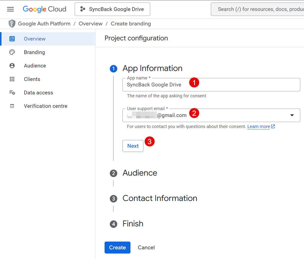

  6. Once enabled, click OAuth consent screen on the left of the window.
  7. The OAuth overview screen will eventually appear. Click the Get started button
  8. Enter an app name, e.g. SyncBack Google Drive, and use your own Gmail email address for the user support email, then click the Next button.

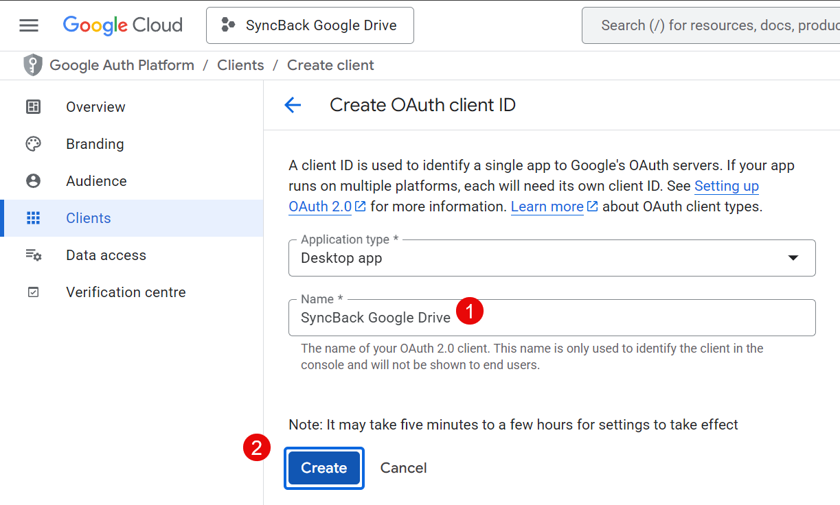

  13. For the Application type select Desktop app
  14. Enter a Name, e.g. SyncBack Google Drive, then click the Create button.

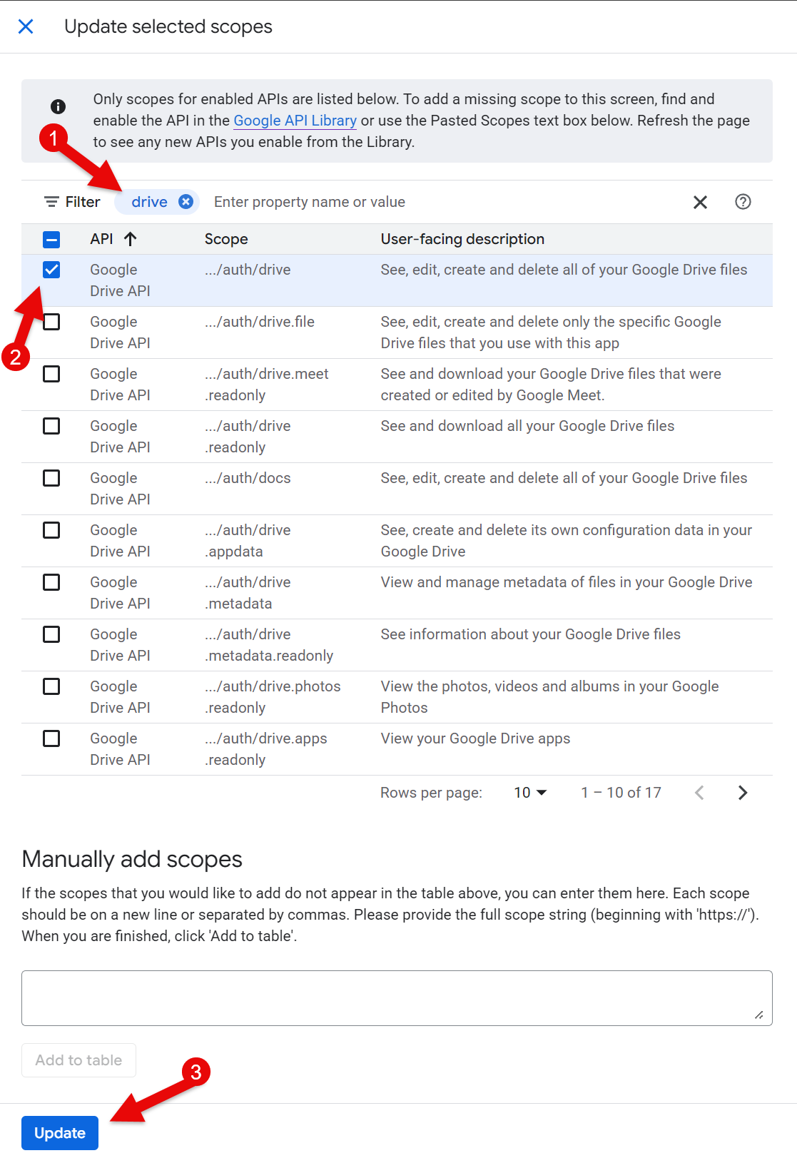

Scopes
We now configure what access SyncBackPro will have to Google Drive. This is done by using Scopes:

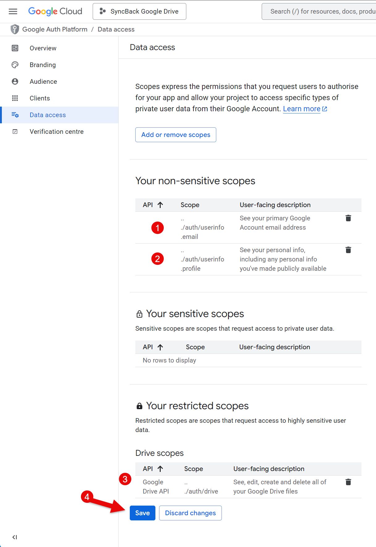

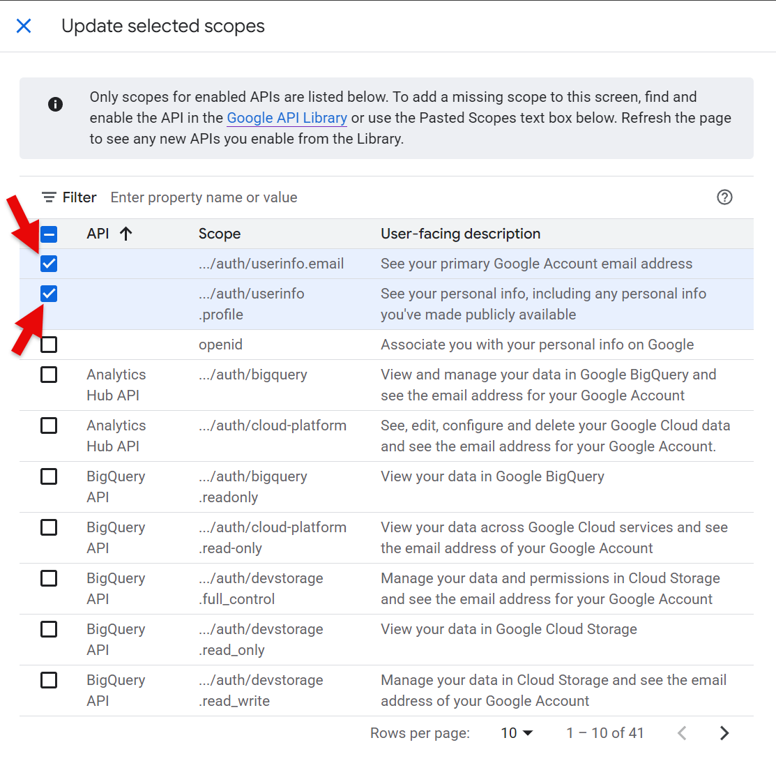

  1. Select Data access in the menu on the left of the window, then click the Add or remove scopes button. A new window appears on the right side of the screen.
  2. In the Filter table, tick the userinfo.email and userinfo.profile checkboxes.
  3. In the Enter property name or value edit box, enter drive and press Enter. Tick the Google Drive API checkbox with the Scope .../auth/drive then click the Update button at the bottom.
  4. You should see three scopes listed: userinfo.email and userinfo.profile in Your non-sensitive scopes, and /auth/drive in Your restricted scopes. It is critically important those three scopes are there. If not, repeat the steps above. If all three are listed, click the Save button at the bottom of the window. It may take a few moments to save.

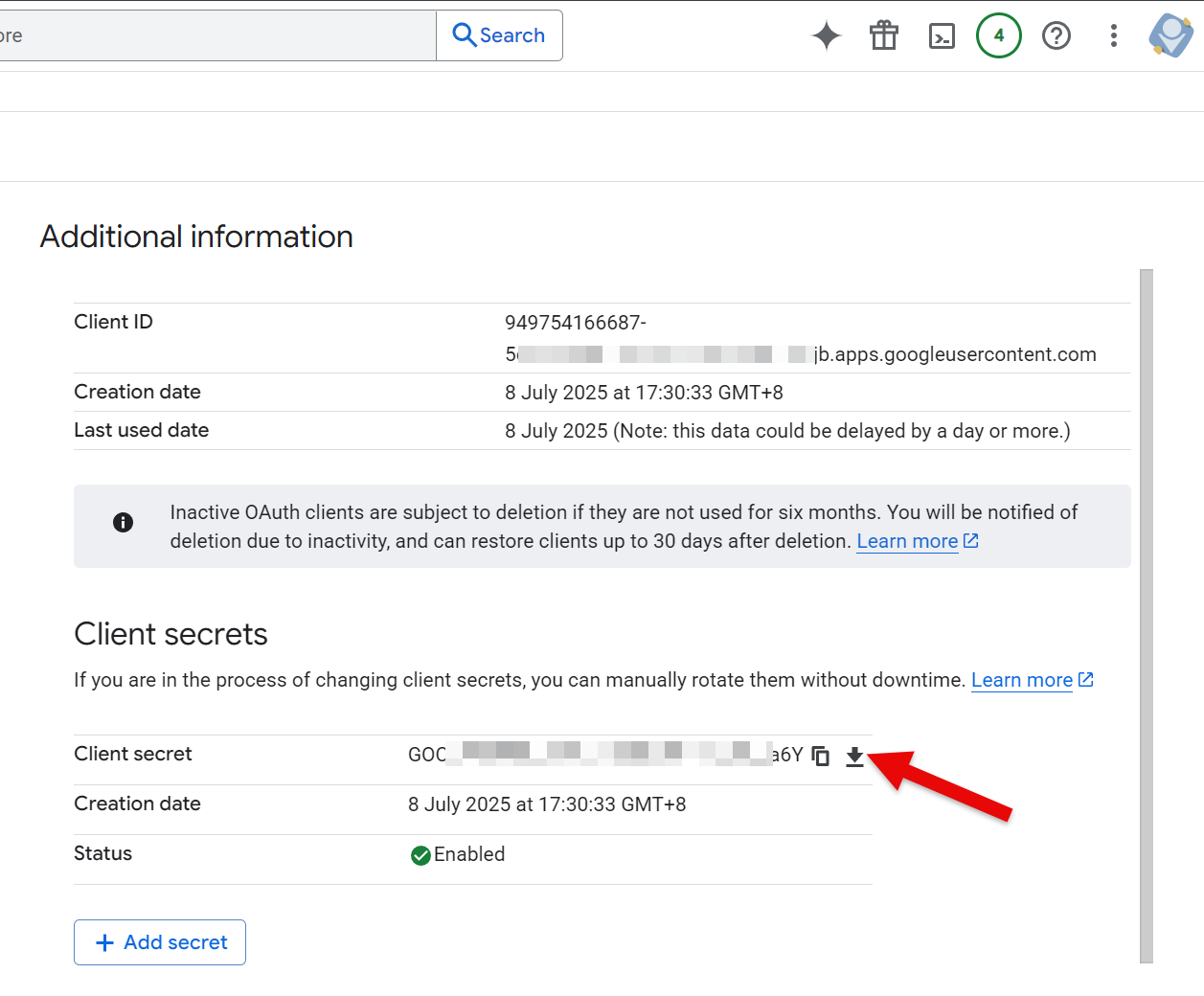

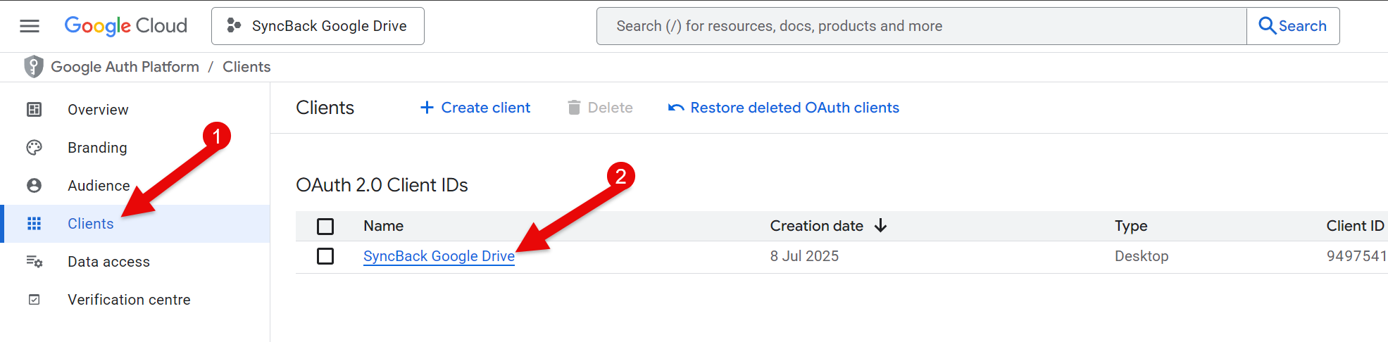

Downloading Credentials
We can now download the credentials that will be used by SyncBackPro to access Google Drive. They can be downloaded to a JSON file, which SyncBackPro can then use.
  1. First, select Clients in the menu on the left of the window, then click on the SyncBack Google Drive entry that we've just created (you may have given it a different name):
  2. Additional information will appear on the right of the browser window. IMPORTANT: If you're browser window is not wide enough then nothing will appear. Click the download button to download the credentials to a JSON file. Take note of where that file is downloaded to as it will be required by SyncBackPro.

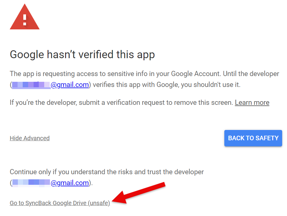

Using it with SyncBackPro

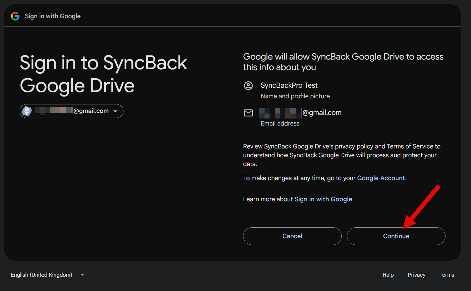

When you first connect to Google Drive from SyncBackPro, Google will need you to approve it:
  1. First, you will receive a warning about the app not being verified. Click Advanced:
  2. Next, click the Go to SyncBack Google Drive (unsafe) link - note that the exact text depends on what you named your project:
  3. Next, click the Continue button:

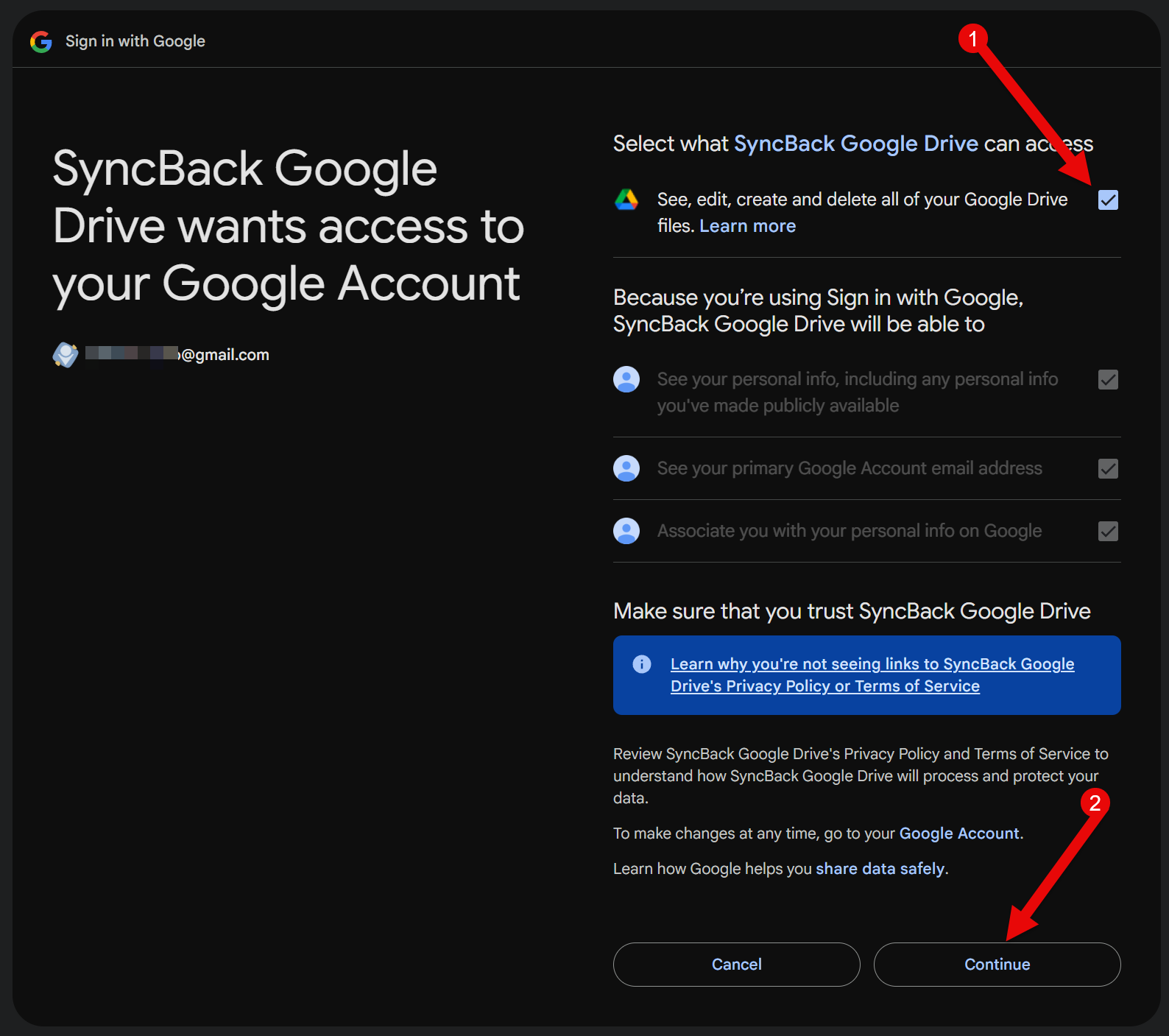

  4. Click the Select all checkbox at the top, then click Continue:
  5. You will now get a confirmation message. Return to SyncBackPro and it will also confirm that SyncBackPro is authorized:
