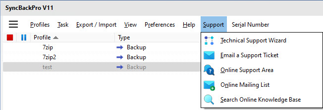

•Once the profile has finished, or the task completed, immediately select Support > Technical Support Wizard from the main menu. Do not edit the profile or perform any other task as this may delete or invalidate the debug information:
tech-support-menu
