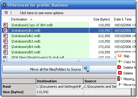

Next the Differences window
will appear (click the screenshot below
to enlarge):
This lists all the files
that will be restored. Remember: the
files being restored (your backup files)
are on the left and the files being replaced
are on the right. You now have an opportunity
to not restore some files or change how
files are restored (by changing the Action for those files, e.g. Skip). Once you're
happy with the selections click the Continue
Run button (or Continue
Simulation button
if this is a simulated restore). You
can also abort the restore by click the
Abort button.
Assuming you continued
the restore, and it wasn't a simulated
restore, then your files are now
restored.
